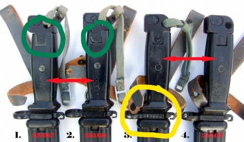

I now understand about the numbers not corresponding with production. However the pictures above bring up a couple more questions.
1. What is the significance of the number stamped on the crossguard?, (yellow circle). I have seen this on orange ones issued as fighting knives by the FRG. Do these stamped numbers come from the DDR or FRG?
2. The details of the pommels look different to me. (green circle). The shape and dimension of the pommel where it meets the grip seem a little longer and more squared at the corners. Also the diameter of the grip retaining screw seems smaller.
I am not sure if these differences are a result of my vision, the angle of the pictures or maybe just the adhesive on the bayonet. Mike

by mill_speer
Hello
1.) The stamped numbers on the crossguard are East German,
not officially, Internal tolerated.
This was done mostly at the border troops.
The border troops have the bayonets, towed daily.
The BRD did not particularly care about the bayonets, they were an inherited evil.
Just like the licensing and production systems of the DDR Wieger STG 940. Caliber 5.56
There were millions of national wealth destroyed, unbelievable!
2.) The Pommel (green circle) is all okay, the screw has the same size, it
There is a lot of glue in the joints. Not typical!
In the middle oranges DDR M.74 I see white glue-sticks of a label.
Best Regards
