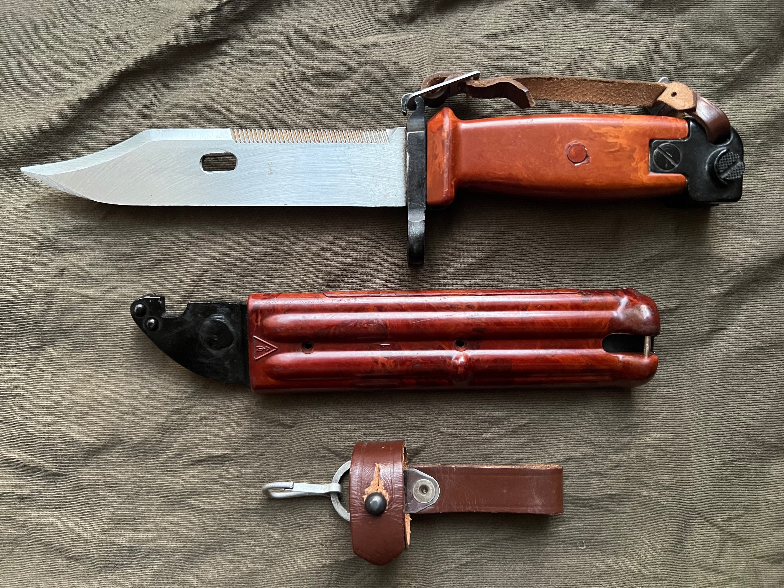

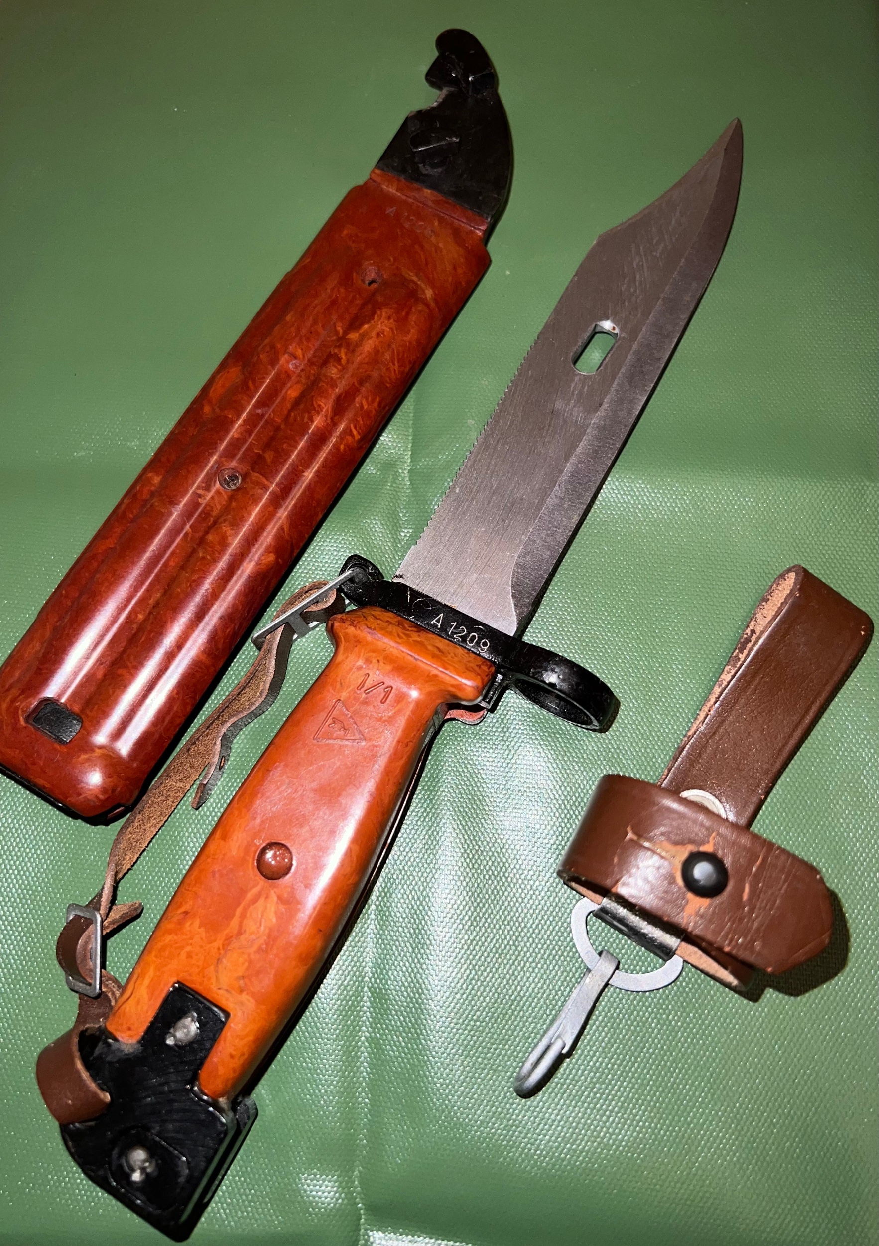

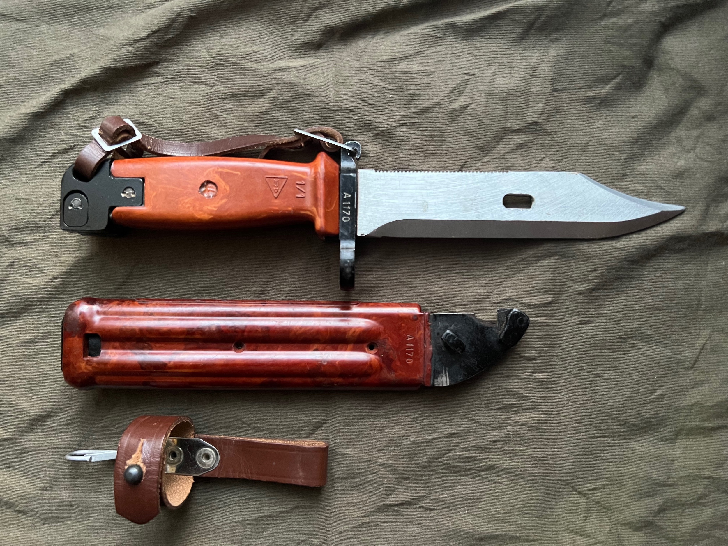

I just recently added two new Romanian 6x4 bayonets.
One being an “A1170” serialized SA contract and a regular Romanian army issued.
Here is pictures of the SA contract bayonet. It came complete with the original strap and hanger.

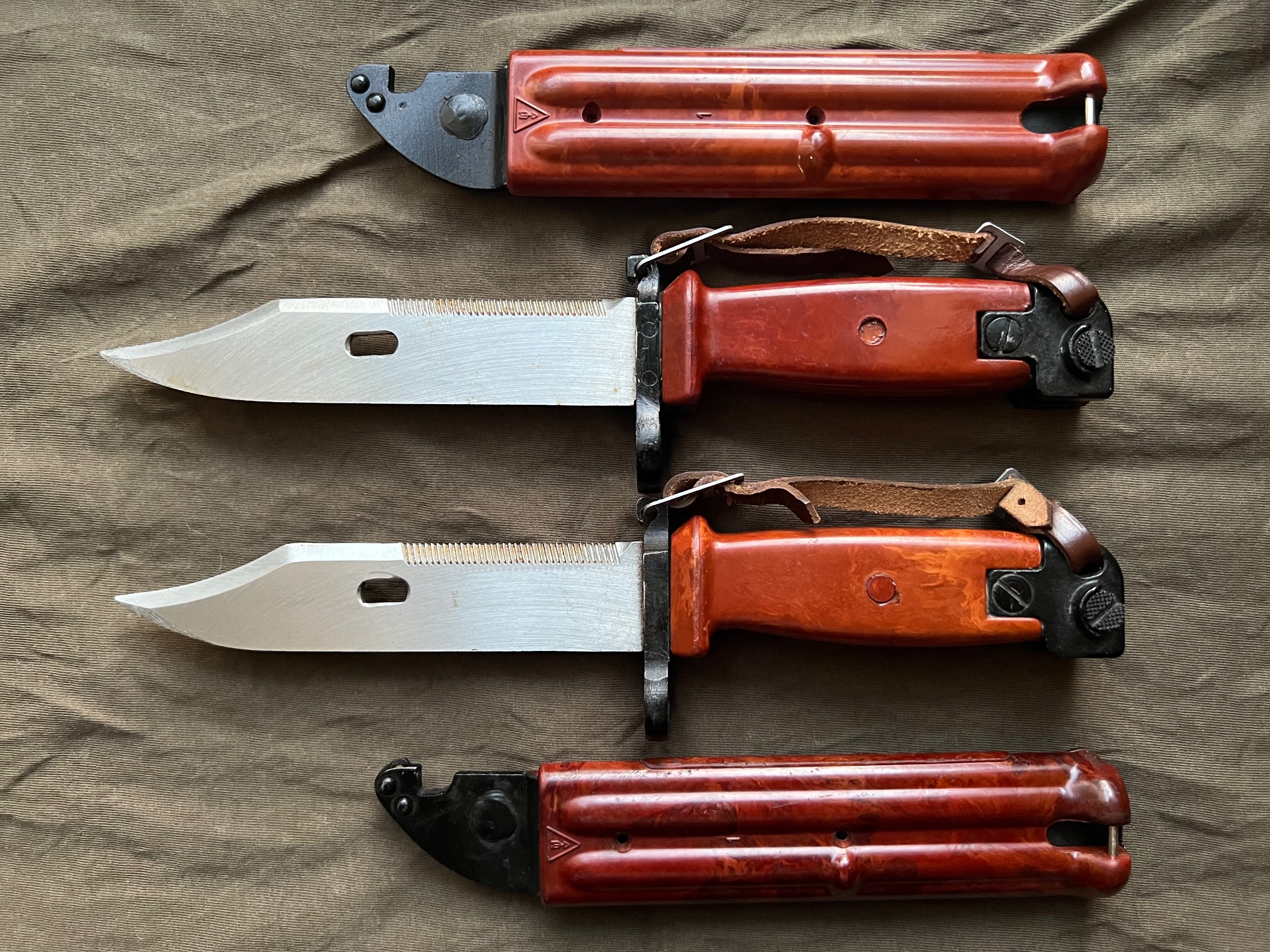

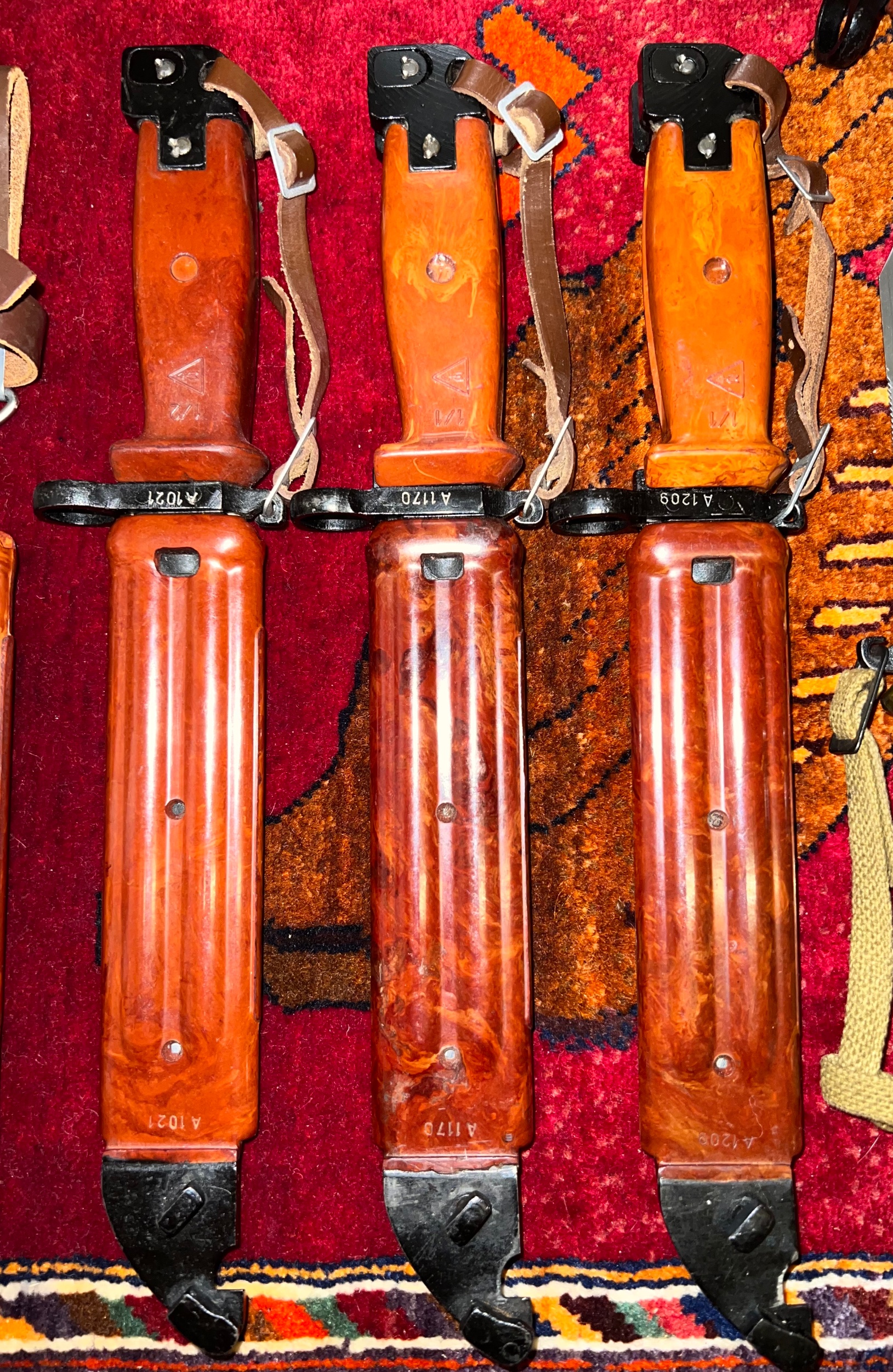

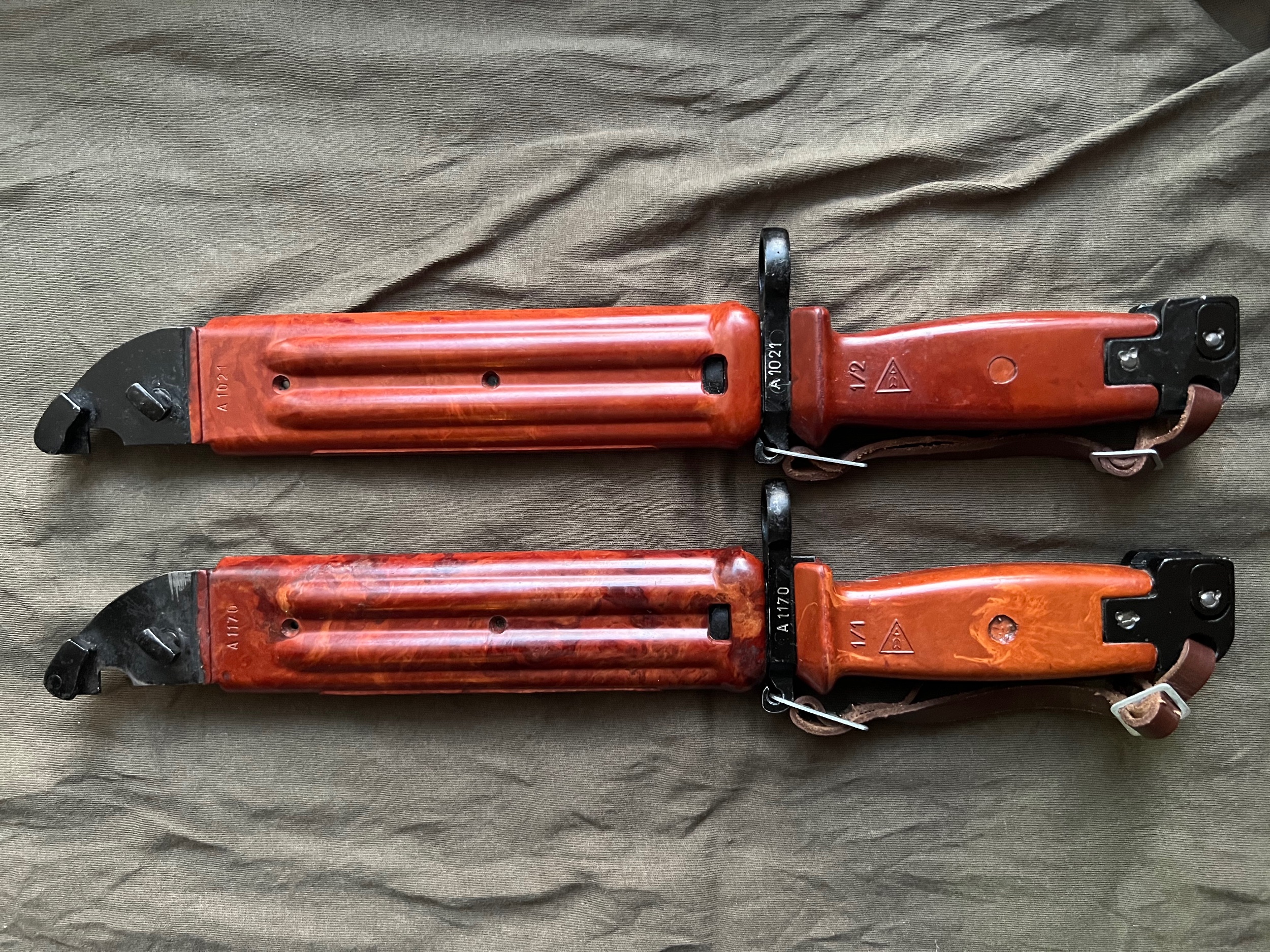

Here is comparison pictures to my other SA contract bayonet serialized “A1021”. The “C” stamp on the cross guard is only present on “A1021”. From a few sources I have heard that the “C” only has been observed on bayonets within the A10xx range. Can any one confirm their observations in regards to that? Brian perhaps?

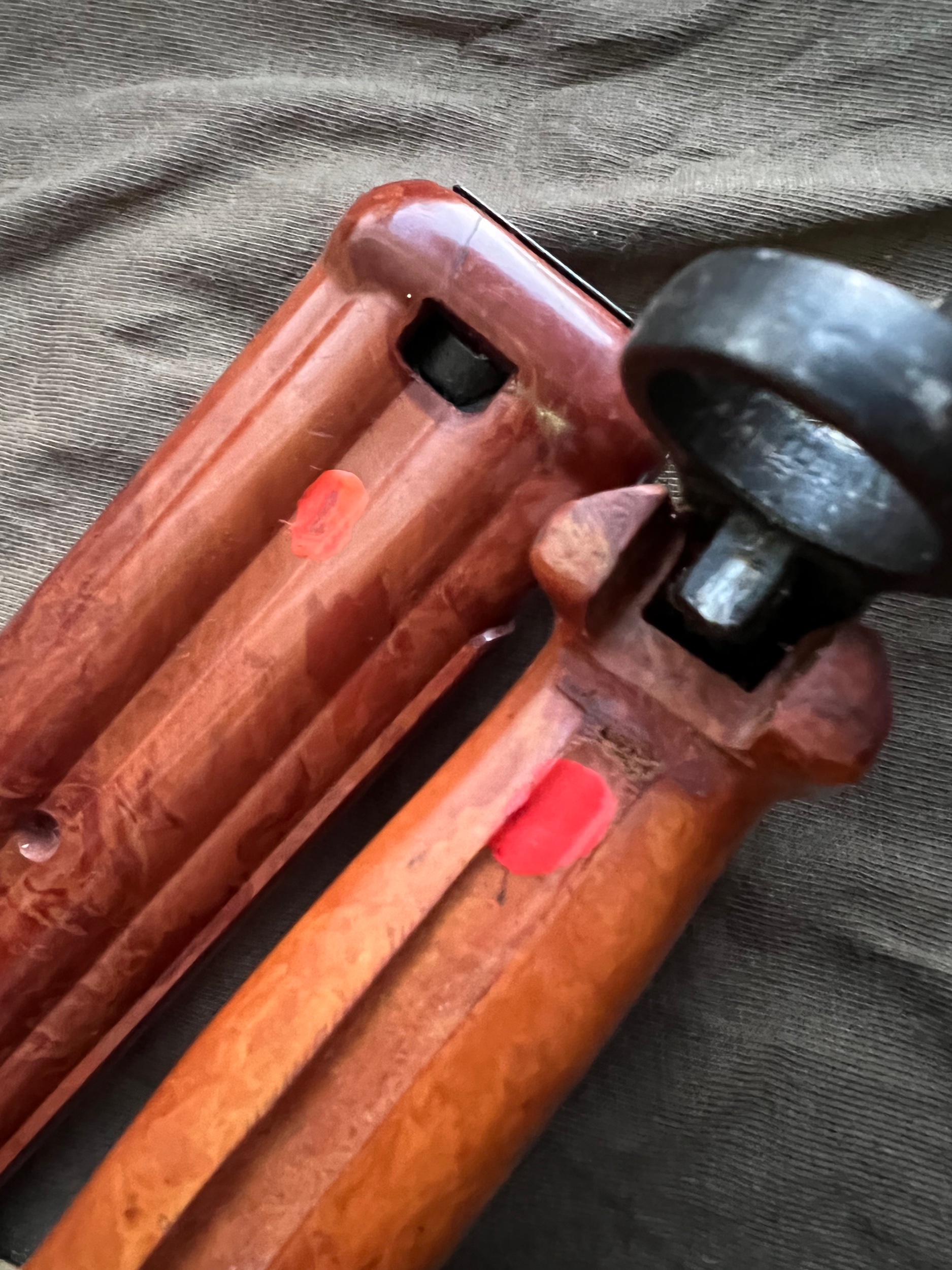

Here is pictures of my second rom army issued 6x4. Serialized “1345” and proof marked with the pinkish paint. Its interesting how those paint marks were absent from the SA production run.
This example came from the AoA deal back in 2017. It also came complete with a hanger.

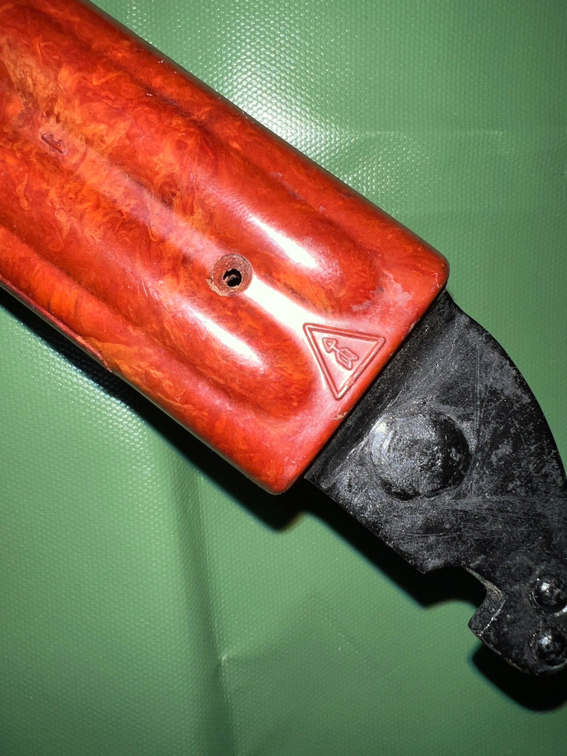

I just added another Romy 6x4 SA exporter.. this one is numbered “1209” and for the record here is pictures.
Im still interested in knowing how many of these that walked out of storage. 20 - 30 pieces?
This one is “C” marked on top of the cross guard.

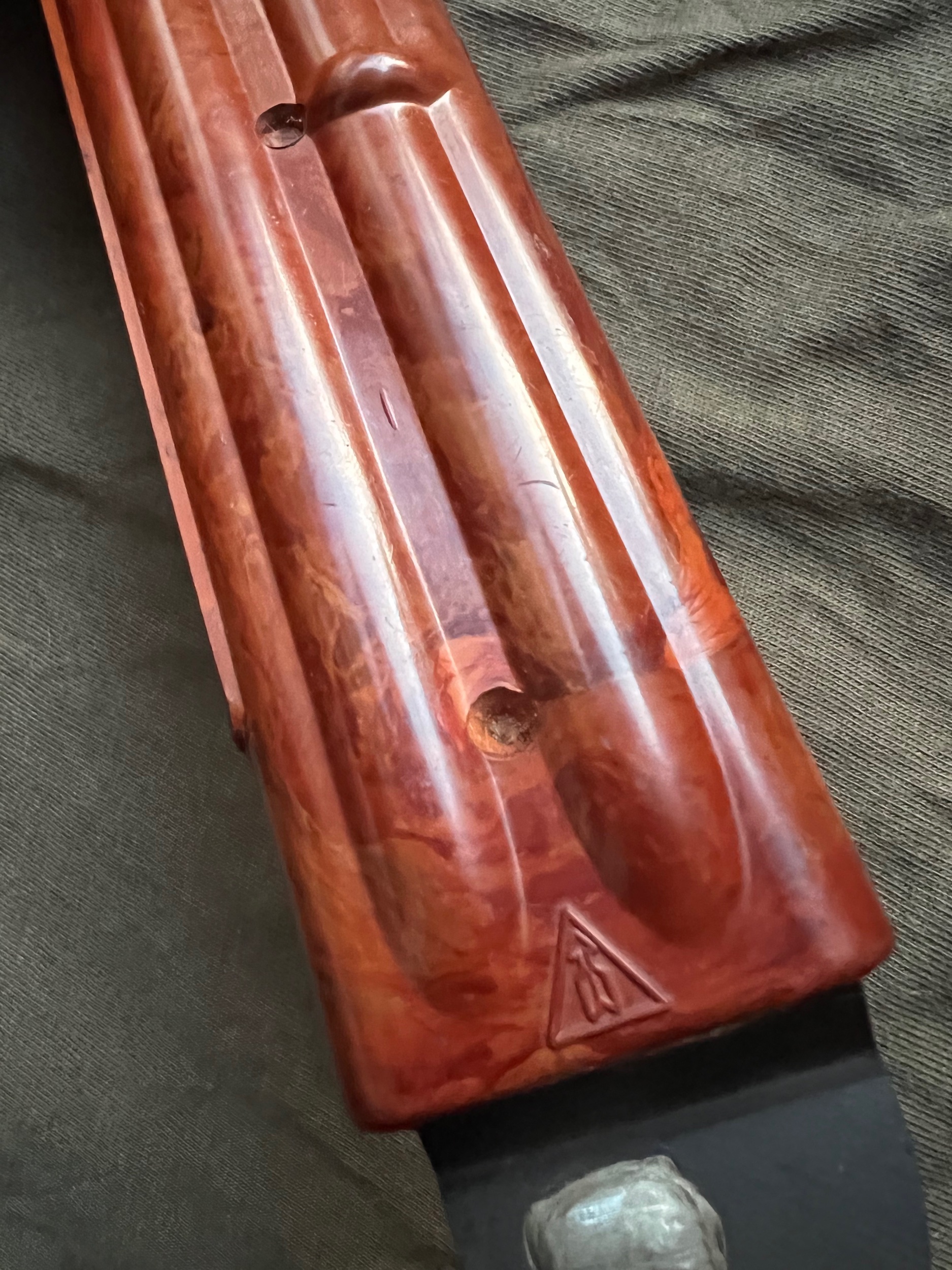

“C” stamped cross guard
