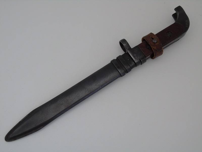

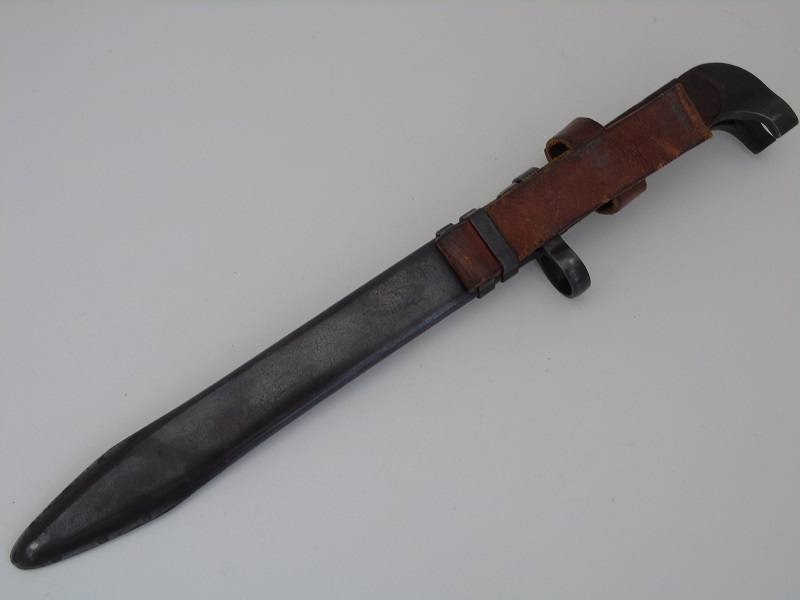

It arrived. Do any of the features shown here help determine what it's all about?
Re: Early Russian AK47 Type I
Posted: Sat Sep 18, 2021 5:08 am
Anthony, before I start with the details, let me say this is a very nice, interesting one of a kind bayonet and scabbard. The pictures are great, but they just seem to add to the confusion for me.
For my best guess, I'll go with my 1st impression of both the bayonet and scabbard together. They appear to be Russian Izhevsk made, early 1st contract for Finland. Early 2 band scabbard, no drain hole, Finnish style numbers. The scabbard could also be early style Russian scabbard that was made without the hole or accidentally missed. The scabbard body could have been replaced at some point with an undrilled one as well as the hanger assembly. A result of repair or rework. I have seen both the Russian and Finnish scabbards with the all leather hangers, both that I have have one rivet securing the hilt strap to the hanger.
The earliest Russian bayonets had the Izhevsk arsenal mark and the numbers on the right side following the curve of the pommel, some stamped, some hand etched. Later Russian stamped numbers were moved to the left side of the pommel and followed the curve of the pommel. The Finnish contract numbers were all stamped on the left side in pretty much a straight line at a 45 degree angle.
One thing I did notice in your pictures may further complicate things. The Russian military acceptance on the right side of the pommel. The bayonets, (and unmarked scabbards) that were not made for Russian issue/use, but for contracts / sales outside of Russia were not stamped. For bayonets and rifles sold or provided to other ComBloc countries all the markings were completely Russian.
Now things get really complicated. After enlarging and studying your picture it is clear to me that the acceptance mark on your bayonet has been intentionally obliterated with multiple strikes. Why? Failed inspection? Remove from inventory to be used to fill a Finnish contract? Removed to be sold to some other country / user? This is one of several similar weird AK47 bayonets I have seen recently with strange markings and other markings lined out or missing. I am wondering if some 3rd world country dumped some of these on the surplus market.

Here is an enlarged copy of one of your pictures showing the marked out Russian military acceptance stamp. Below is a close up of my earliest Russian AK47 bayonet showing the acceptance stamp, (flattened diamond containing CB), and the original long Russian numbers. In MHO, I would file your bayonet and scabbard as Finnish 1st contract.

I spent at lot of time comparing your pictures to all the AK47 pictures on this forum under Finland, Russia and unknown items. Take a look at them and see what you think. Mike

Thanks for your time and consideration on this piece Mike.
It had me guessing too and the quirks are what drew me to it. I doubt we'll ever really know what it's all about and can now only hypothesise about it.
I wondered, as did you, if the acceptance is stamp was obliterated because it was pulled to make up numbers for possible non Russian military 'contract fulfilment' purposes as opposed to a 'quality' fail. I was also puzzled by the two purposely struck dots next to it.
Who would assign and apply the serial number? ... the Izhevsk factory or the intended recipient? Either way it must have passed final acceptance as that would have been the last thing done ... unless of course the acceptance stamp was obliterated after an overhaul event at some point in its lifetime?
Too many unknowns.
Anyway, it's in my catalogue as Russian manufacture for a Finnish contract.
