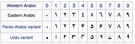

Very interesting AKM 6X4 Type II bayonet and scabbard. It does appear to be an early Russian made version from the Tula arsenal. Correct manufacturing markings and even the off-white inspection stamps. A question would be why would someone go through the time and expense of grinding off a star and striking over a small one on the crossguard? What and where are the original issue numbers? Not much evidence of their removal. Why would Egypt hide Russian markings? They supplied the machines, technology and even parts to make these bayonets. The Russians also provided / sold them to several countries in the area.
The main question for me would be the added matching “Egyptian” numbers. I remember lots of discussion about the differences between Western Arabic, Eastern Arabic, Farsi and Persian numbers. The fake Egyptian made 6X4 Type II pictured above was discredited by fake markings and numbers. Regardless, the Egyptians and other countries involved in this conflict used what ever was available at the time. This one is Russian made, supplied and numbered in a different country and possibly used by Egypt. Collected by an Israeli soldier during Yom Kippur war in 1973, but difficult to prove.

We seem to have wandered of track. Your original post was about your Egyptian marked Tula 6X4. Here is what we know for sure. It is Russian made, apparently at the Tula Arsenal. Someone, at some time, in some place has added what appears to be Eastern Arabic numbers. There is virtually no way to confirm who, where or when. These Russian bayonets and scabbards have been distributed world wide. Arabic numbers do not make it Egyptian!

Let’s start over with your bayonet and scabbard. All the other pictures are out of context and of no meaning to me. Your bayonet is a Russian AKM 6X4 Type II early version with the machined pommel and crossguard, (no visible rivets). These were made from 1965- 71. From what I can see it was made at the Tula Arsenal. The original arsenal marks have been stamped over or removed so no confirmation. However, the round rivets on the scabbard cutter plate stop and the off-white paint stamped inspection marks on both the bayonet and scabbard seemed to be from Tula. We can not see if there are original numbers or Russian Military acceptance marks, (OTK or CB or a flattened diamond shape). The style and placement of original numbers and Acceptance marks could tell us if they were made for Russian use of if for a contract with an other country. The matching five digit Eastern Arabic numbers indicate a large number provided or sold to an unknown Arabic country or group. If this was a contract order these numbers could have been placed in Russia or by the new owners. They do seem to be somewhat consistent in style and placement, but use both four and five digits?
All that plus the fact that Egypt manufactured their own rifles, bayonets and scabbards, I doubt that your bayonet and scabbard were used by the Egyptians. Do your homework concerning the Yom Kippur War in 1973. Egypt and SYRIA attacked and invaded Israel. Several other Arabian groups were remotely involved supplying aid and weapons?
