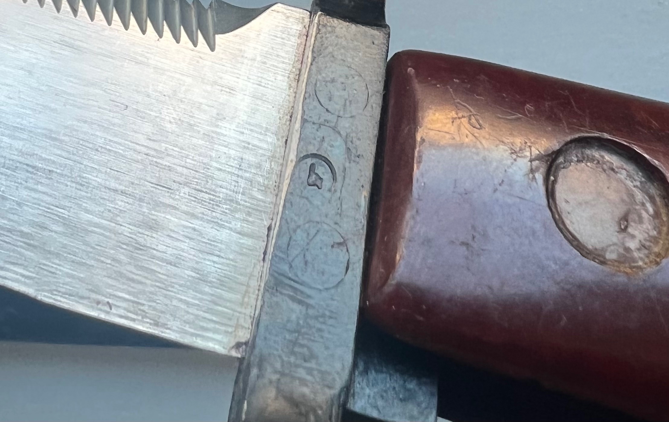

Thats true Gerhard, there are som faint markings there. I’ll try to get pics of all stampings.

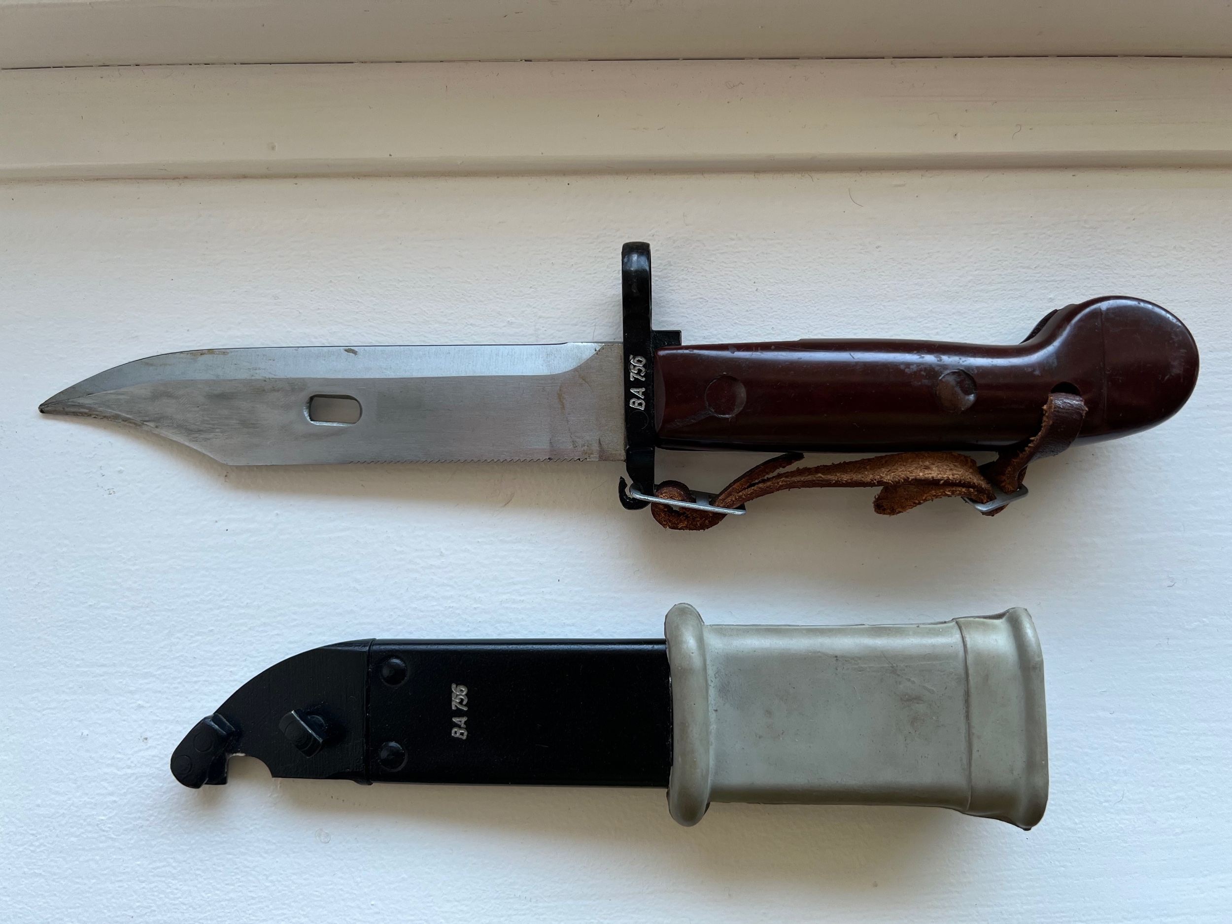

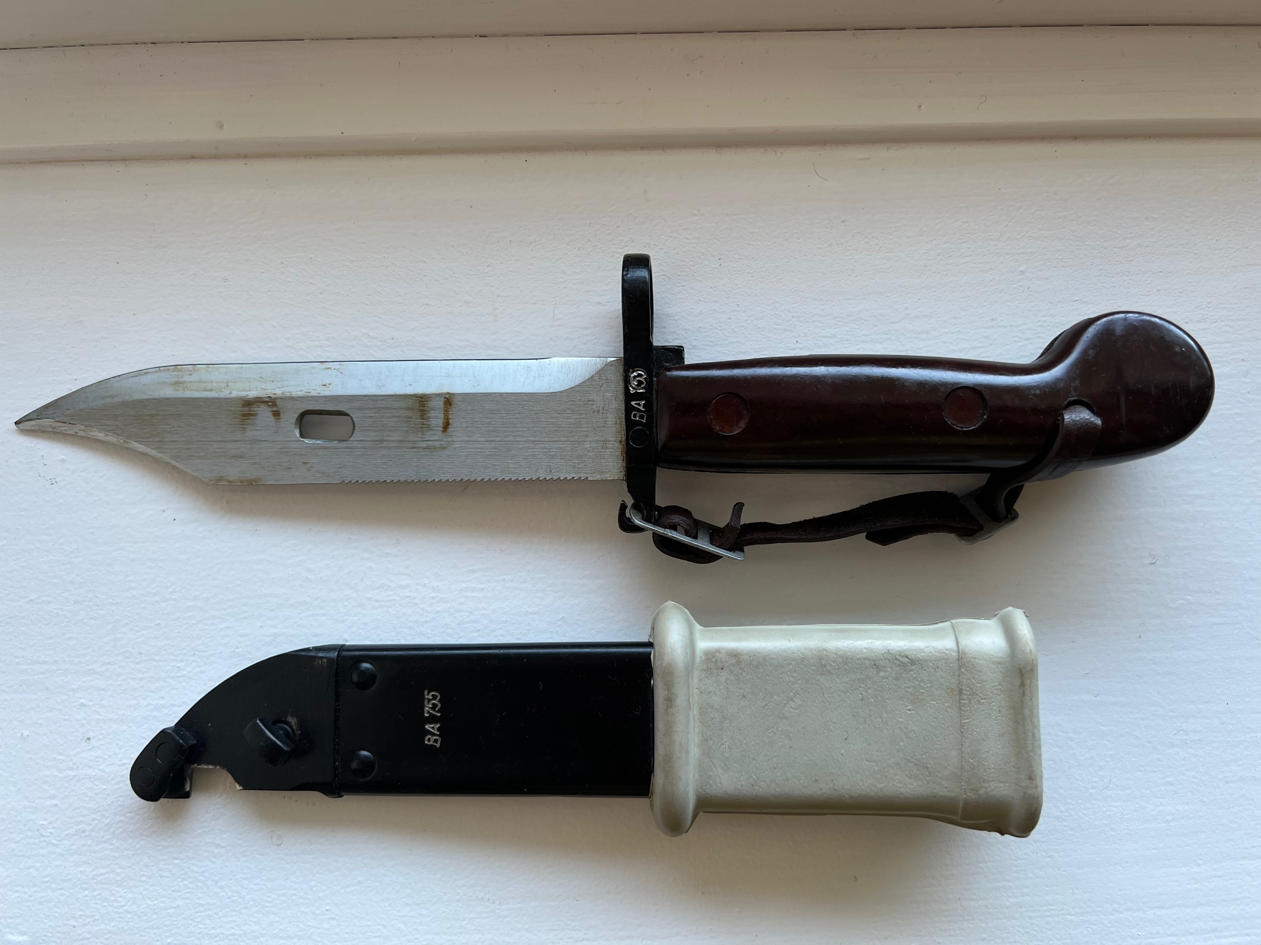

After inspection I found a marking on the scabbard of BA 463 and 756.
Stamping of what appears to be a “B”. On 755 there is no stamping.
I dont know if this is present on the regular wide pommel Romy 6x3, but its the first time I see it.

It’s interesting how the “letter-thing” keeps reoccurring on the Romy bayonets.
B,C and H is found on 6x4 model plastic scabbard.
C is found on 6x4 SA contract models on top of the cross guard (spotted on the 10xx serial).
B is seen on flat pommel 6x3 scabbards.
I wonder what they represent.

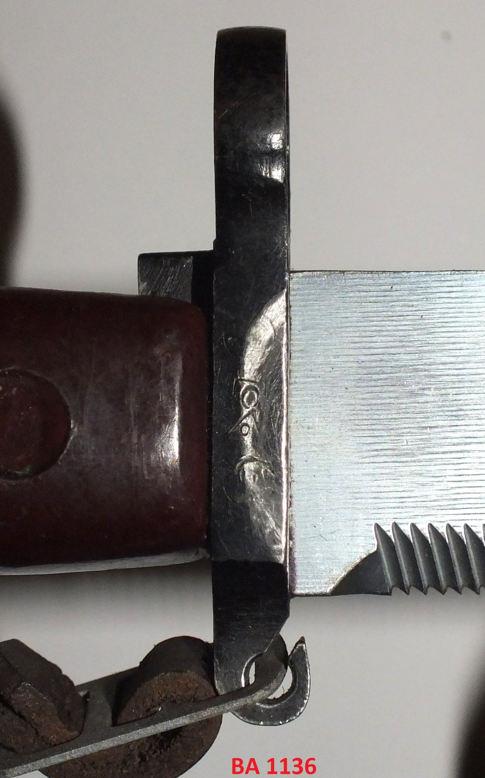

Unfortunately, I can't see a clear line or standard on the acceptance stamps of the Romanian bayonets. This is probably due to the mentality of the Romanians. Apparently they didn't invent quality work. Unfortunately, it is very rare to find bayonets with a clear acceptance stamp.
I can't explain the letters on the Scabbards, I have my theories about it, but I can't find any evidence for it.
I'll show you a few examples.

Thanks for sharing the photos Gerhard. Yes, the stamping of these bayonets are of very inconsistent results. Hard to see what is going on.
The arrow in triangle in particular.
But yours had a very visible arrow.
With permission of another gentleman im uploading a few pics of RS 3747 for the record.
Again hard to get any reading of the stampings.
