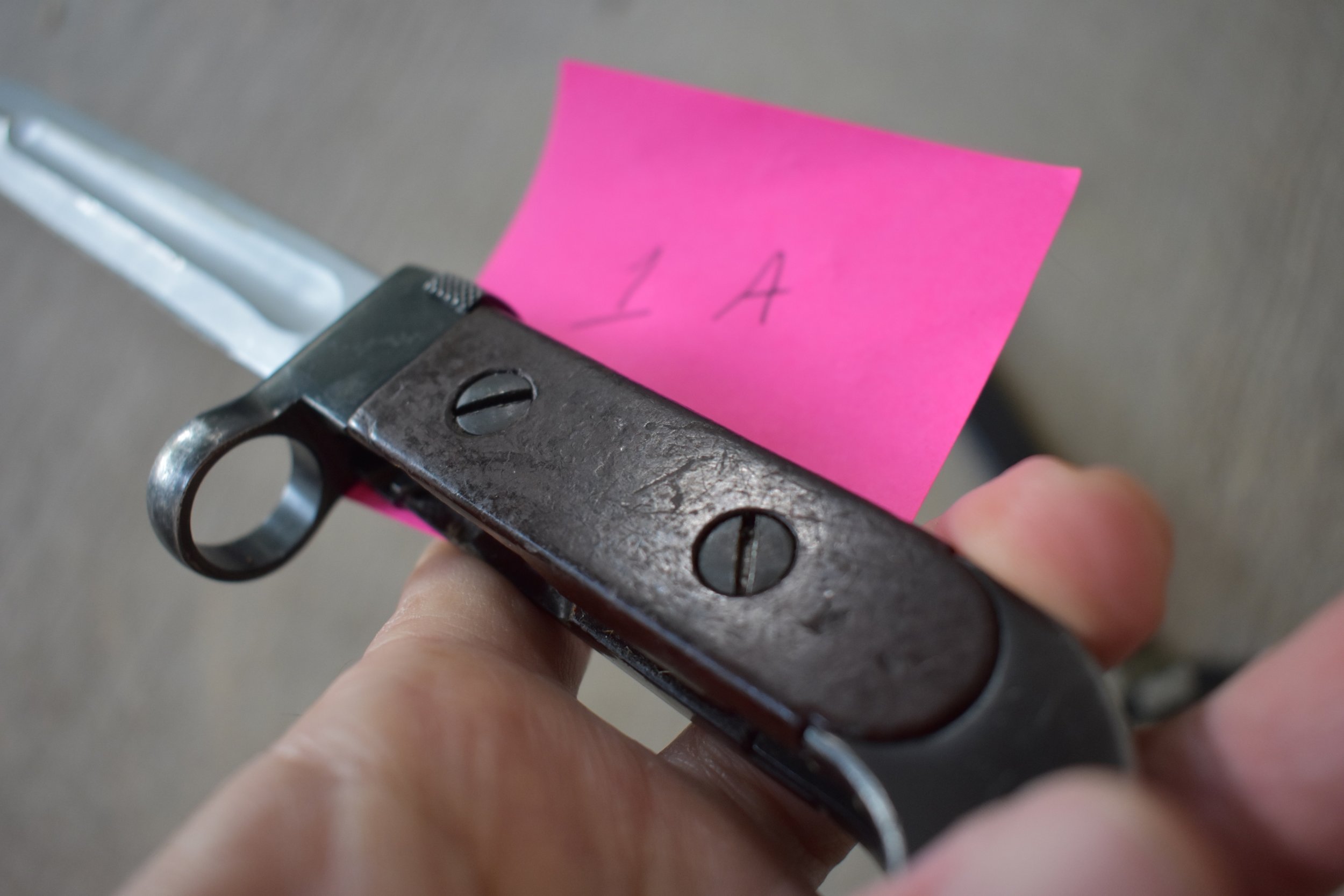

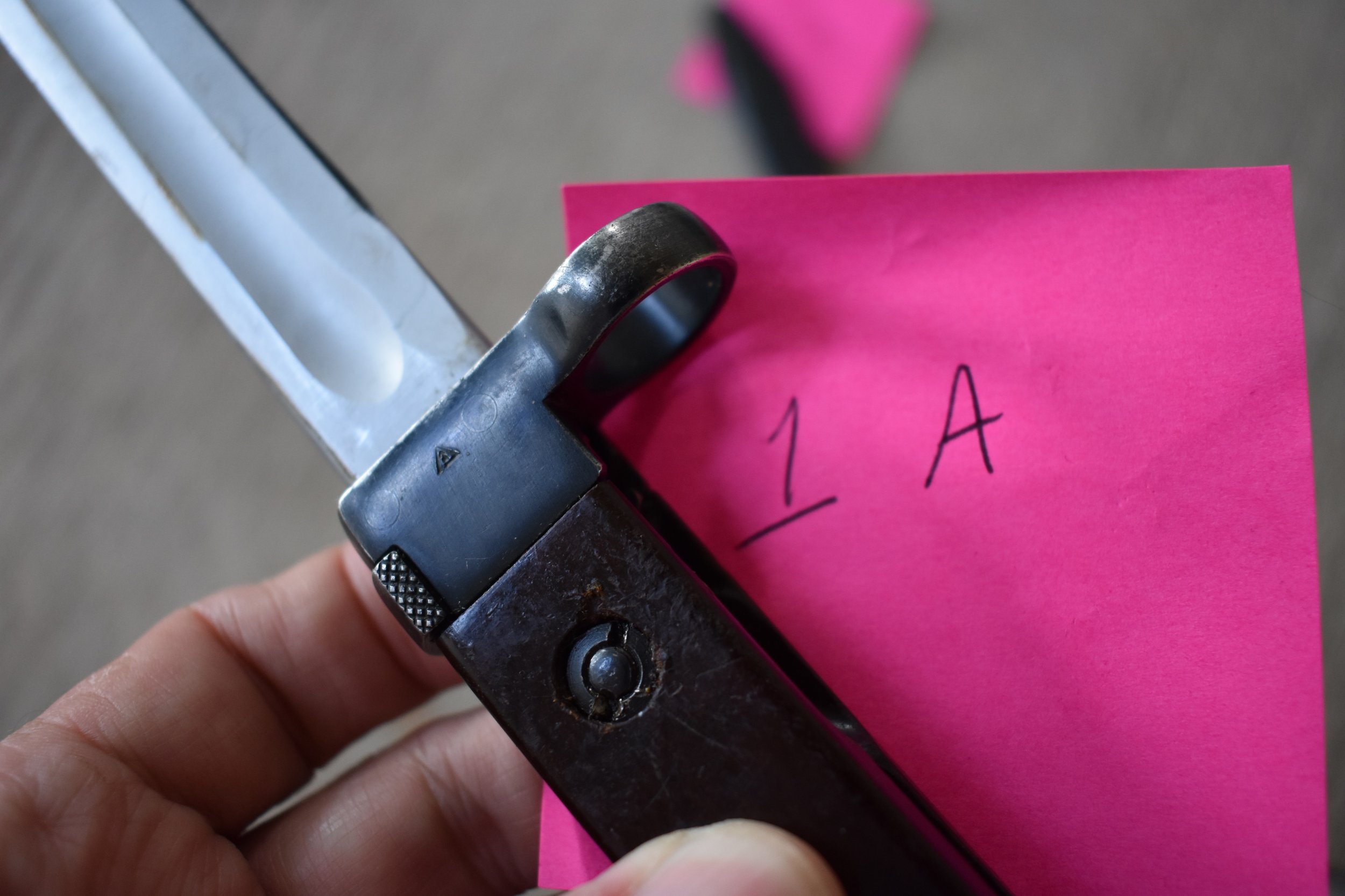

Hey guys, got a couple bayos here that i'm trying to confirm so i can match up with kits & rifles. any help would be greatly appreciated.
this one came with what looks like a bulgy scabbard and the bayo looks blued

Re: 6X2 Bayonet Identification
Hi Adam, I'll try to help identify these bayonets and scabbards the best I can from the pictures provided. I would usually prefer to call this style of bayonets as AK47, rather than us the Russian 6X2 designation. All four of the bayonets pictured were made in Russia at the Izhevsk Arsenal. They all have the arrow in triangle arsenal mark stamped on the left side of the cross guard. Bayonets 1A and 4A have what appear to be Russian style serial numbers stamped on the left side of the pommel. The numbers are irregular and follow the curve of the pommel. Bayonets 2A and 3A have smaller, more aligned numbers stamped in a straight angle which is more Finnish in appearance. To further ID theses bayonets you must examine the right side of the pommel for markings that can't be seen in your pictures. The ones accepted, issued and used by the Russians will have a flattened diamond containing the letters CB on the right side of the pommel. If there is no acceptance mark the bayonet, they were made for export to other countries, most commonly this was Finland.
You can also check out the posts on AK47 bayonets on this forum under this topic and under each of the individual countries that used issued/used them. More on the scabbards later. Hope this helps. Mike

Now for the scabbards. Scabbards are more difficult to identify as they are usually unmarked and un-numbered. They can only identified by general features and appearance.
1B is an early two bar Bulgarian scabbard that has been reworked/repaired. The Bulgarian scabbards typically have the drain hole on the back side and two rivets securing the hilt strap to the hanger. This one has had the internal chape rivet drilled out and a replacement style hanger installed.
The last three, 2B, 3B and 4B are all Russian, but with different variations. 2B is an early 2 bar scabbard. Typically the Russian ones have the drain hole in the front and the hilt strap is secured to the hanger by one rivet. This one also has an unusual flat sided stud on the hilt strap. Unfortunately, the hanger has been badly damaged. 3B is also an early two bar Russian scabbard. Again the drain hole is in the front and a single rivet on the hanger. The all leather hanger may be original, but I believe it is probably a replacement. Usually the original hangers are fabric with a leather or synthetic hilt strap. Nice example of an early scabbard. 4B is a later style Russian scabbard. Drain hole is in front and it has the one piece sheet metal hanger bar. This is a very nice example of an original scabbard. Mike
To sum up all four bayonets and scabbards. You have four Russian made bayonets that may be either Russian or Finnish. You have one reworked Bulgarian scabbard and three different Russian ones. My suggestion would be to combine the bayonets with the military acceptance mark with the Russian scabbards according to condition. If any of the bayonets are without the acceptance mark they are Finnish and belong in Finnish scabbards. The Finnish scabbards have no drain holes and the hilt straps are secured to the hangers by sewing. I hope this info helps. Mike
