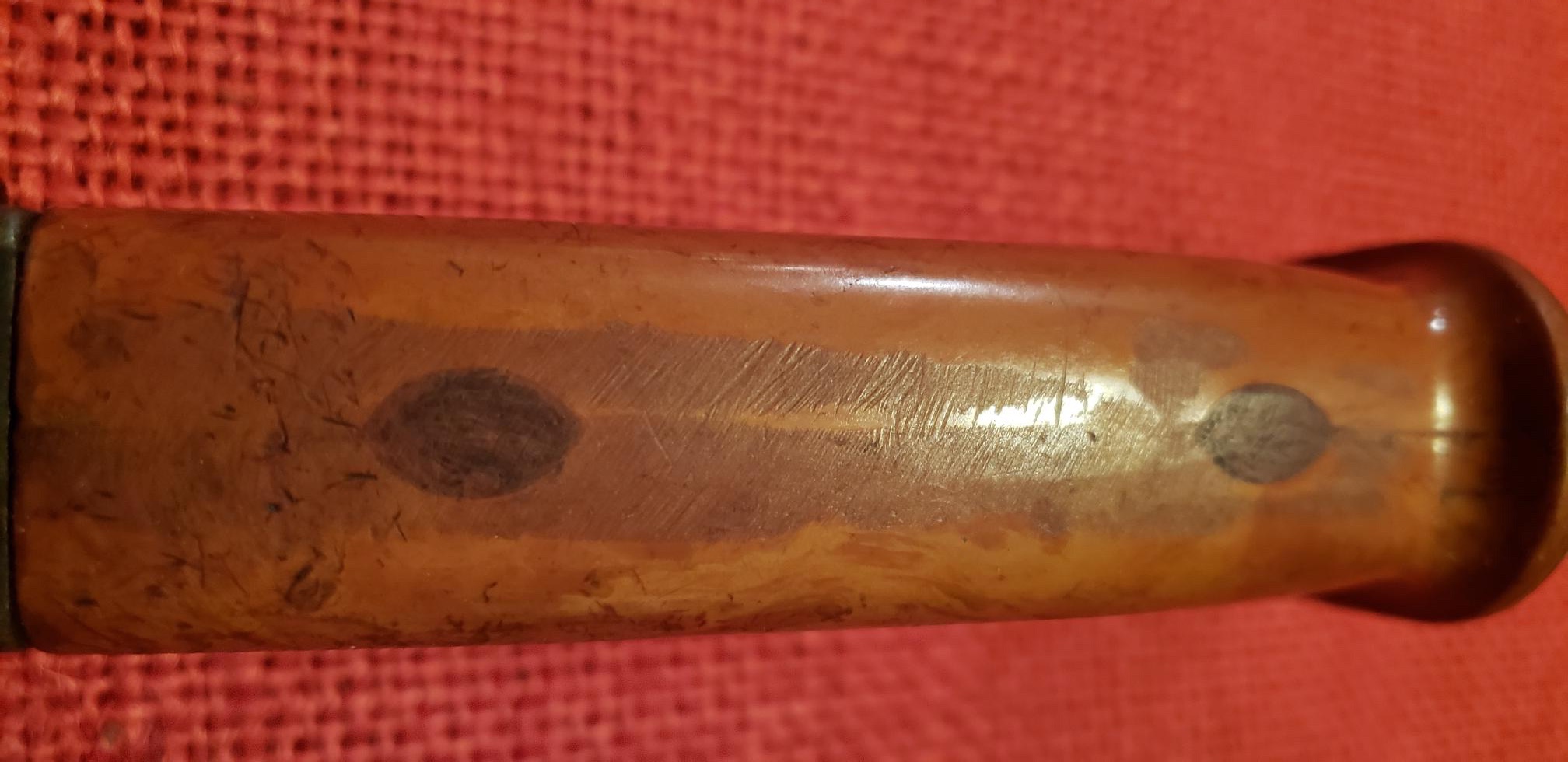

The bayonet appears to be an Iraqi AKM 6X4 Type II. I am unable to confirm that from the picture provided. The numbers are illegible and other markings are not visible. There should be elliptical mold marks on the bottom of the grip. (Sample below).

The first picture is an enlarged one of the bayonet hilt pictured above. The numbers are blurred and unreadable. The second picture is a sample showing the mold marks on the bottom of an Iraqi Tabuk bayonet grip. If they are present on the bayonet at the top it would help confirm that it was Iraqi. Mike

I know this bayonet, it's Iraqi. I don't like the combination.
I've never seen a DDR M.59/2 - M.74 sheath on an Iraq mix. And the Romanian green webbing hanger is also atypical for it.
Otherwise, I agree with Mike's comment.
